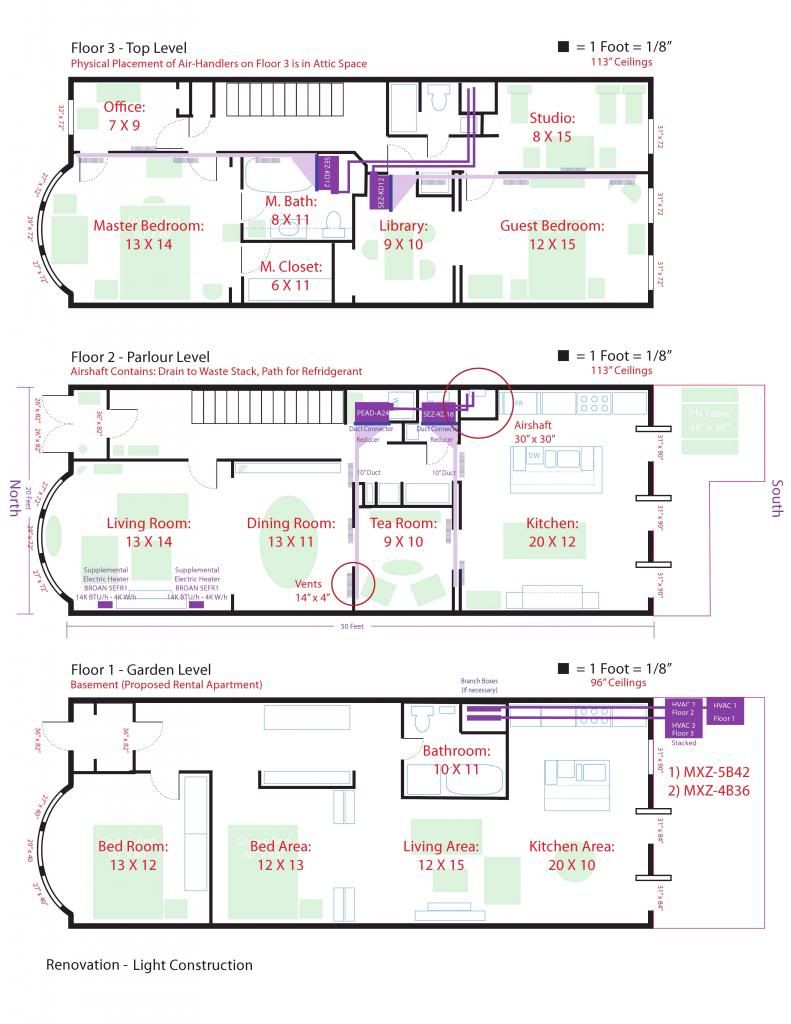

Hi steam_man– To answer your question directly– no not yet, but my GC has assured me he has and can do the job…. More on that later, perhaps in another post. The above floor plan is really a compilation of an incremental HVAC installation strategy. So, we may not use every compressor shown, may swap air handlers, or may even go with a city-multi “S series.” The diagram basically serves to calculate heat loss and display ductwork locations. The key word above is STRATEGY. I’m gonna start with the MXZ-5B42 driving only blowers on my second floor, and see how it goes. Truthfully, I have been told that this single unit (3.5 ton) could drive the two floors I need heated and cooled– but I’m skeptical. But, this unit will give me a chance to install, and more importantly, feel various air handlers– from 12-24k BTU, PLUS get the ductwork installed while the framing in my house is “open.” Now, I have heard as many opinions on what, where, and how to install heat pumps as there are settings on a thermostat (little joke there!) The first thing one needs to get over is the reticence in this geographic area to heat pumps in general. I know your feelings on this, and obviously don’t dispute your views. I’m going through an educational process for a large investment, so I’m trying to see all sides of the issue before I “pull the trigger”– but in the end there are several physical, financial and other considerations which are driving me towards heat pumps, although the general consensus seems to be that they are still risky in this geographical area. Since there are so many varied opinions, and I STILL have not found a dealer willing to physically show me a site with a Mitsubishi installation, I’m gonna do this piecemeal with my GC. There are only three things which have been consistent about a heat pump installation with knowledgable people I have talked with suggest: 1) In this area (NYC, Brooklyn) Mr Slims will need a supplemental heat source on cold days — City multi, or Hyper heating models will work at low outside temps but are expensive 2) Install more cooling BTUs upstairs, as hot air rises in the summer — There are simply more hot days than cold days in this area, this drives the system decision 3) For short runs, simply use the largest duct possible, no need to worry about static pressure — the whole SP thing could drive you nuts Now I have dozens of other comments, some may be helpful to others– so I’ll post as time sees fit.. Cheers.

jjq, Thank you for the nod. Just so you know, Mr. Slim doesn’t use branch boxes. Have you gotten proposals for this design yet?

http://i1159.photobucket.com/albums/p635/jjq90/image.jpg
We have settled on the above plan for our HVAC/heat pump system. More comments to follow if image displays correctly.
